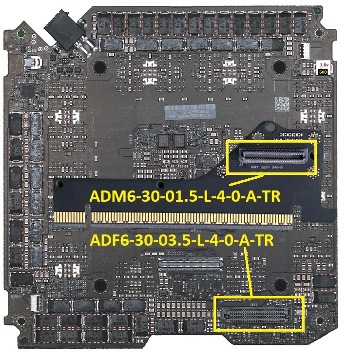

www.levirepair.eu/infusions/forum/attachments/5090fe_parts.jpg
